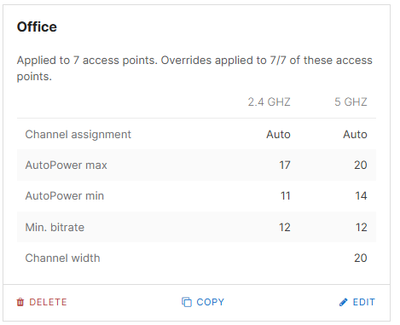

I suspect the tx power is very high hence clients further away will connect to this access point and saturating it with users complaining about Teams calls and other network activity..
This is the TX power settings in the RF profile

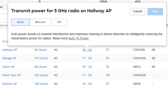

@AxL1971 15dBm isn't particularly high, but could be reduced, are there any overrides to the APs in that area?  If you go to the radio settings page in the dashboard, you can see the current settings and click to confirm if there are overrides:

no overrides set to Auto, what is best dbM setting to use, I would like to keep the signal footprint to a optimal settings, so clients will connect to the access point closer rather than this particular one.

The AP you have shown has the 2.4 down at 2dBm which will be a very small coverage area.  However, you stated that you only use the 5GHz band.  If your APs are fairly close together, I'd go with a maximum of something like 10 dBm, but make sure this doesn't leave gaps!

I put the incorrect setting, this is for the correct one for the 5 Ghz
cmr
@AxL1971, how close together are your APs?  That one is down at 2dBm as well, so will have a very short range.
