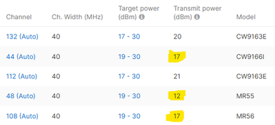

The signal power of a Meraki AP can be controlled through a profile or overridden manually for one AP.  However there are limits based on local regulations and the exact AP model and connected antennas that may not allow the maximum power to be realised as seen highlighted below:
The profiles are under Wireless / Radio Settings / RF profiles
The overrides are under Wireless / Radio Settings / Overview - check the AP and click on the Edit Settings button.
