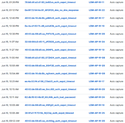

Hey, it would be great to have the option to choose between proactive on select AP's you have now or have a deliberate configuration where you select a few clients to track and ALWAYS capture their probes, auth, assoc, disassoc, reassoc, dot11v, dot11k,4way handshake, and action frames pertaining key exchanges.  This feature would provide a ways to monitor certain clients for a while if issues arise.
The problem with the current implementation is that most proactive captures happen when a client decides to roam but has a EAPoL timeout due to it roaming again.  These captures are mostly quite useless since they usually don't show a problem.

While I do like the function, the current way of doing it will result an many pcaps littering the storage while being of little use since many of them will just be client roaming decisions.
- Some of these are also mismarked: Like the no DNS response just contains an ARP request ARP reply conversation where these are repeated several times.
