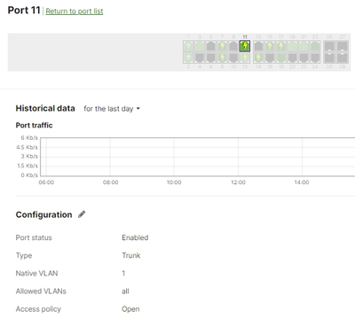

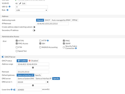

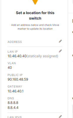

With my fortigate, I wish to access the Meraki AP.
The issue is that the AP is not coming up even if the SW is coming up after I inserted a static IP address inside the range.

SW

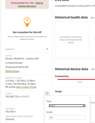

AP

FORTIGATE SIDE

As per your pictures... You need to set the native VLAN on the port that connects to your AP (port 11) to VLAN 40.
Keep it as trunk and put the native VLAN on that port to VLAN40

Purroy
ww
In that case, also remove the 40 from the vlan field of the ap management address
You need to get it to the point that if you plug a notebook into that switch port it can get Internet access.  Perhaps start at that point, and once that works plug the AP back in.

@Purroy i putet the native vlan  like 40 and @ww  cjhange the mgmnt   the AP comes up without tag  thanks guys
