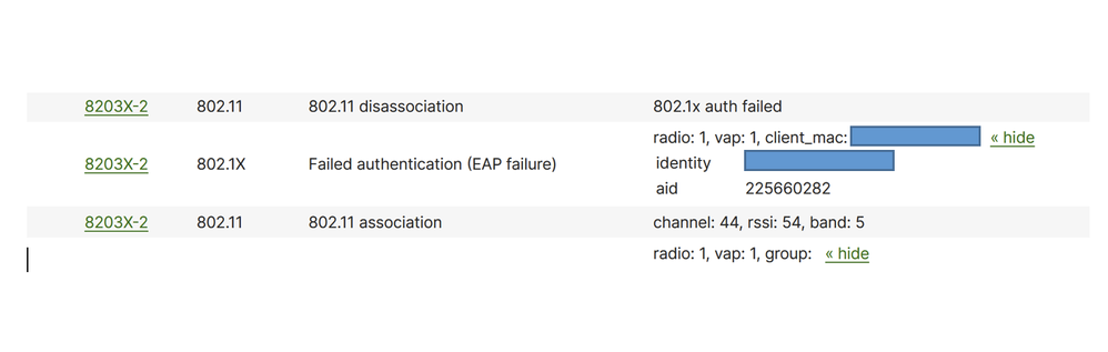

When used by authenticators other than the Meraki AP, the NPS authenticates known PC clients and allows them onto the network, but when the Meraki uses the NPS, I get this in the log:
Now this is a Wi-Fi 6-capable AP but there is a statement on the dashboard: "This SSID will not broadcast on the 6 GHz band. Use WPA3 to enable this band." During limited testing time, I set the AP to use WPA3, but I'm concerned that the issues I'm seeing are due to the Authentication conversation being trashed because the AP wants WPA3 and the PC is using WPA2.

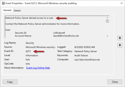

ChristophJ
Can you also check the event log for the NPS and send the screenshots of the logged requests?
You can find it in "Eventviewer -> Custom Views -> Server roles -> Network Policy and Access Services"
The logs should look like this:
(The picture is just an example I pulled from Google)
It should also display why the authentication to the NPS failed when you scroll down further.
