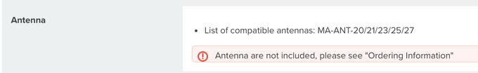

RWelch
OEM replacement antennas specifically for the MR76 (as listed on their spec sheet).
