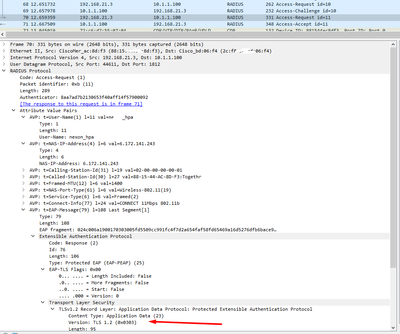

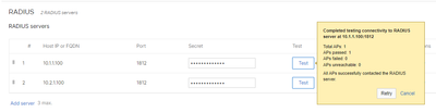

First Site is called "Site B" is working 100%. It runs an MR42 Clients mobile phones, PC's etc can join the wireless with Dot1x Radius Auth, and the Dashboard test button for Radius under SSID passes the tests using my confirmed valid and active Domain Username and Password. Passes for both Primary and Secondary Radius tests under SSID page.

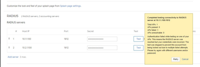

Site with the issue is called "Site G". It runs an MR32 AP.  At "Site G" the PC's and mobile phones are working fine. They are able to auth successfully via dot1x radius authentication and they ARE working. The only thing that fails and never works is the Meraki Dashboard Test button for Radius. It fails against both Primary and Secondary Radius test buttons using the exact same Username and Password as "Site B".

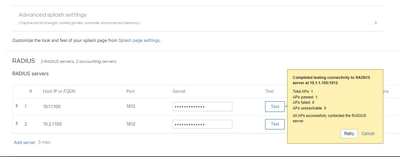

Third site for the customer is called "Site S" It runs an MR20 AP. At "Site S" PC's and mobile phones are working fine, authenticating successfully via dot1x radius authentication. Meraki Dashboard Radius Test button tests pass at this site each time testing with the same Username and Password tested above.

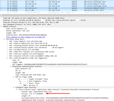

"Site B" does the tests from the Dashboard Radius test button using TLS1.2 which is configured correctly on the Server.

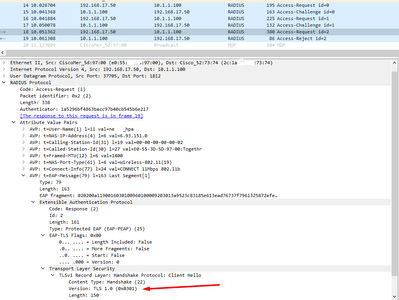

"Site G" does the tests from the Dashboard Radius test button using TLS1.0 and is rejected as the server is configured to disable TLS1.0.
The clients running on the LAN are correctly using TLS1.2 at "Site G" the only place that TLS1.0 is used is on the Meraki Dashboard Test.
