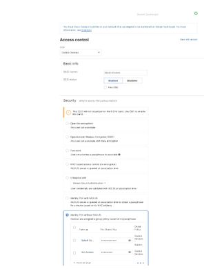

Do you have any restriction configured on your SSID? What type of athentication are you using? Can you show the SSID configuration?

I asked you you about the configuration, but you did not send me the screen shot.

My mistake... here's the current config for that SSID
