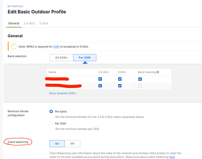

Don't try and do that. It will create a lot of work for you.
If the APs are near each other you can try reducing the power levels to encourage roaming.
Under Wireless/Radio settings/Profiles, start by using some values like these:
