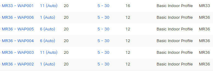

Hi,
I have recently been supplied with MR36 APs rather than the MR33 we ordered due to supply issues. I installed my first batch of MR36 and found that the transmit power maximum setting is only 12 where as the MR33 is 16.
"1 radio is incompatible with a max power of 16 and will be set to its highest compatible power."
As we have planned the install for the dBm being higher it has had an affect on the coverage.
I have checked the datasheet for the MR36 and there is no mention of the dBm at all.
Please see screen grab below:
I'm not sure why the transmit power is lower? Any thoughts?

You have your 'Target Power' range set from 5 - 30dBm
Your 'Transmit Power' is the value the AP is actually using.
Since you have default settings, the AP will determine (using magic) which power level it will use.
For whatever reason, it settled on 12dBm
You can manually change this to a different value, or, you can tweak your 'Target Power' range settings to not go below 16 for example.
Your power level will vary per frequency, and also depend on what country you are operating in, as far as 'max' goes.

The maximum Target power for the MR36 is 12.  If you go to the Target power for the MR33 it's up to 16 (when you try to set manually).
I have logged a support ticket and this is being investigated.  I have been asked to try Beta firmware (27.4) to see if the power can then be increased and they are also going to be speaking with the developer's team.
From what I understand the MR36 should be able to have the same maximum transmit power as the MR33.

I'm in the UK.  Please see further details below:

@PJ51182 we are running a couple of MR36s in the UK with 27.4 and indeed get the same issue as you, both were running on 12 with 5-30 set on the 2.4GHz band.  I tried overriding one of them and and if you pick 13 upwards then the same warning about the radio being incompatible comes up.

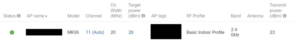

I have some on 26.8.1 (United States) and I just set the power manual to max, and it went to 23dBm. So I suspect its due to domain regulation issue.
