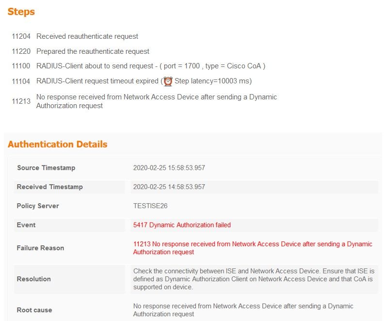

After entering the correct username/pw on the ISE CWA portal, the COA was sent from ISE to MR33.
However, I encountered the following MSG on ISE, it seems that COA failed because MR33 is not responding.
I did enabled COA on Dashboard SSID Access control.
Is there a way I can verify the COA/port 1700 is enabled on all MR33 AP? Telnet?
My AP and ISE are on different subnet, no firewall in between them.
