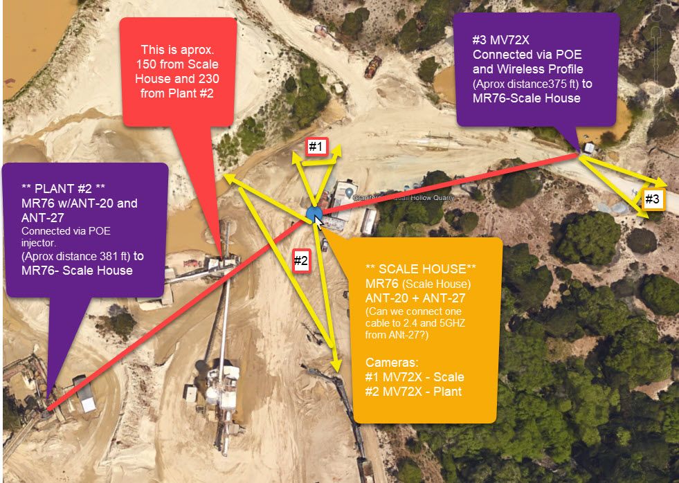

Question, we are trying to mesh/Bridge two MR76 with ANT-20 and ANT-27 antennas. To connect some MV72X cameras and provide wireless coverage.
(Maybe MR84/86 would be better to cover the distance?)
We have our Scale house centrally located.
We plan to install MR76-#1 on a Telephone/Power Pole next to the Scale house.
We will connect Cameras #1 and #2 via ethernet connection.
Camera #3 is about 375 feet away, we want to use a POE injector to give it power and use a Wireless profile to connect to the MR76-ScaleHouse. There is some trees in the way of line of sight.
We are also looking to install another MR76-Plant-02 which is about 381 feet from the Scale House. And Plant-01 is in between. Plant-02 is about 40 feet above it.
With the MA-ANT-27 from one MR76 to the other, will that span that gap? Can we connect the MA-ANT-27 to one of the 2.4GHz and one of the 5GHz on the MR76. and use a ANT-20 on the other side?
This connection for Plant-02, is for wireless coverage and to add another camera or two in the future.
