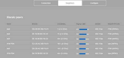

Once connected to the WiFi, open this web page:
http://my.meraki.com/
It reports in real time the AP you are connected to and the signal strength.

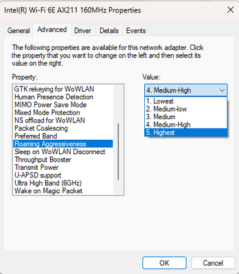

It may help to set the roaming aggressiveness in your WiFi NIC settings to the most extreme setting available.  This will make it aggressively roam to the closest AP.
Make sure you change the setting back when done.
ps. Make sure you look at the "Neighbors" tab when you do this to see the real-time signal strength.
