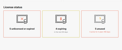

Dear Team
How to activated this license unused active?what do you mean about unused active license ?
so that unused license the device access point can't use and can't running normallay after license unused and not activated
3 Replies 3

Active & Unassociated (Unused Active) - A license has not been associated to a device, but has started to burn. This typically happens when the grace period is over, but the license has yet to be associated to a device. In this state, the license can only be applied to a device that does not have an active license (e.g. a new device).
https://documentation.meraki.com/General_Administration/Licensing/Meraki_Per-Device_Licensing_Overvi...
This could also just be the 5 free MT licenses.
cmr
@EtanaMeraki if you click on the icon it should tell you which license it is.
If it is a license for a wireless access point and you have a wireless access point without a license associated then go to the devices page and you should be able to select the AP and assign the license there.
The reason that everything is still working is that the PDL license enforcement was always flaky and sometimes doesn't disabled devices without a current license.  You do still need to have purchased the licenses though.

Dear All, Thank you for information,
so this device still active cause the license PDL non Co-Term ?
and we need to license to activated device ? usually how long after device expired still can used in dashboard meraki ?
