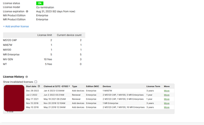

I'm attempting to add an extended license for a some devices that will have an early license expiration because of this. The device for which I purchased the license for a specifics devices and when I try to install it, the mx 64 disappears and an error occurs. I onlyto extend the ms mr, not the mx 64. I belive the CO i am able to extend to device nex to expire in this case MS.MR,MX100 . Why? I always forgot licenses affair

It appears your key only covers the switches, MX100, and 5 APs. So if you try to apply as a renewal it will remove the MX67 because that's not in the license key. Sounds like the license order wasn't correct.

If you are renewing, you should have purchased it for all devices, otherwise when applying, only what was purchased for that license will be renewed.
I agree with the others.  An easy way to fix this is order an additional MX67 licence (quickly) and just add it (not as a renewal).
