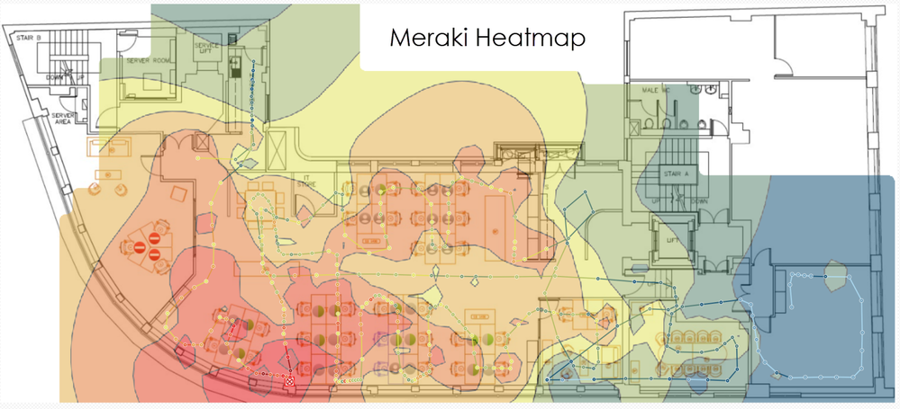

We're implementing MR36 APs to replace our old Ruckus ZoneFlex 7982 APs.
I've been doing some Wi-Fi Surveys (with Visiwave) with the intention of a before and after comparison, but I've found that the maps I'm getting show a much cooler signal from the new Meraki APs compared to the Ruckus.
AP location shown slightly inaccurately by blue circle, lower left (it's slightly further to the right)AP location shown slightly inaccurately by blue circle, lower left (it's slightly further to the right)Meraki signal.pngRnM.png

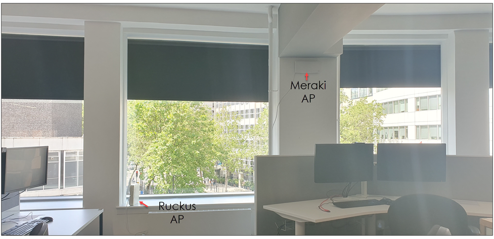

You can see from the photo that the Ruckus AP is at desk height, while the Meraki is mounted high on the wall.  So, despite the fact that the Ruckus AP's position is sub-optimal, it seems to be putting out a better signal than the Meraki.
But is the Meraki performance still likely to be better despite the apparent coolness? What's the best way of performing and A/B comparison?

Both APs are interfering each other. It's not a valid test. You should have power of one of those, and perform a test.

They may or may not be interfering, depending on what channels they have adopted and the Tx power adopted - but certainly, in it's default configuration,the MR AP will be taking the visibility of that Ruckus AP (and any other WiFi transmitters) into account in determining its own settings.

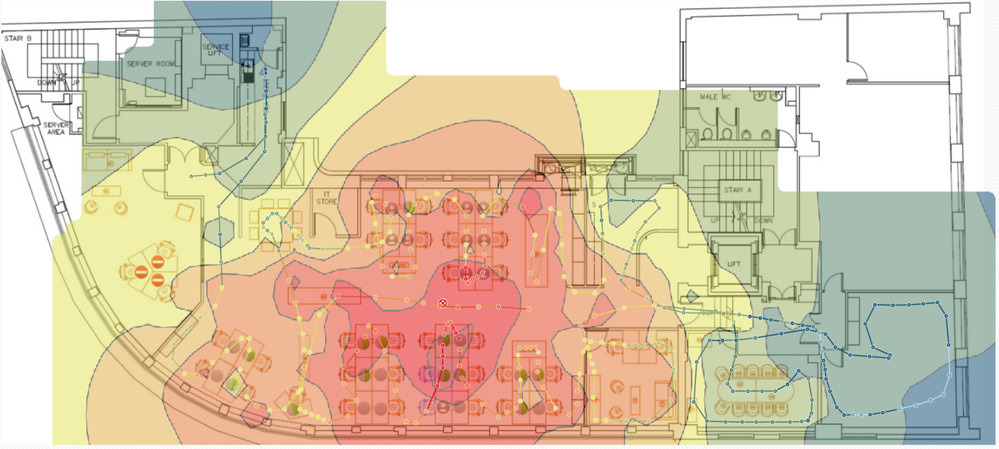

Well, @GreenMan  I'll check the channels in a mo', but as per @alemabrahao 's suggestion I turned off the nearby Ruckus and appear to have got an improved heatmap as a result:

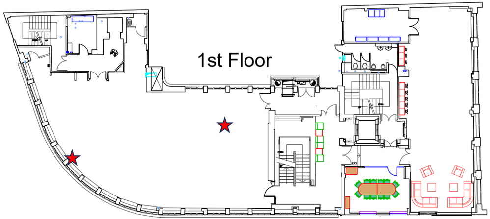

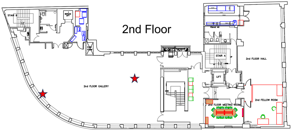

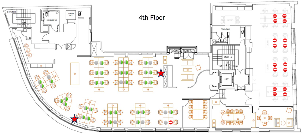

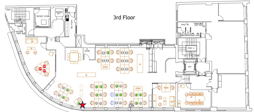

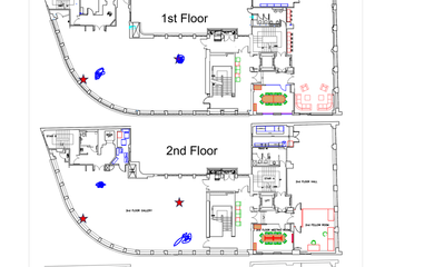

Similarly, though, we have 8 floors in our office building. Floors 1, 2, 3, and 4, all will (at the moment) have APs in the same, or very similar, location on each of those floors. The Red Stars are the AP locations.
So we've got up and down as well as sideways signals to deal with.
In an ideal wireless network design, the ideal is not to overlap the APs on each floor, so I suggest you to change the positioning of the APs between the floors.
Something like this.

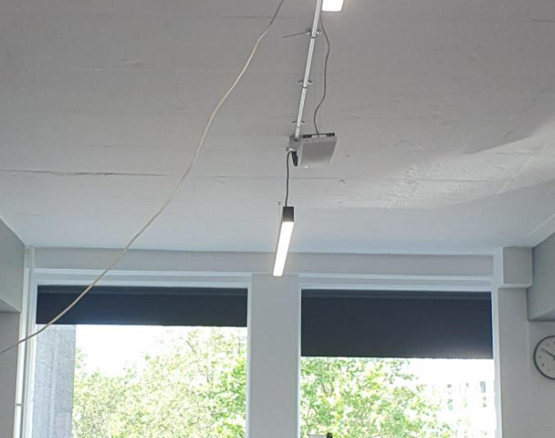

Just as an experiment we tried suspending an AP from the ceiling in the middle of our floor (with the wall-mounted AP switched off):
