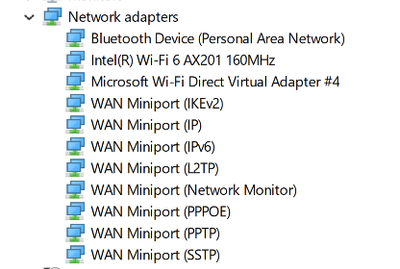

Sorry, I guess I didn't explain it too well....what you described above is what would happen if the PC and the screen both connected to the AP, but thats not how it works in this case. What I have is a PC Wireless NIC that is connecting to an AP, then being shared so it associates with the AP AND the screen. The screen broadcasts an SSID ("DIRECT-") which the PC NIC associates with using a virtual adapter (shown below as direct virtual adapter #4) that is only present after Miracast has been initiated.
so the VLANs and so forth are not involved.
