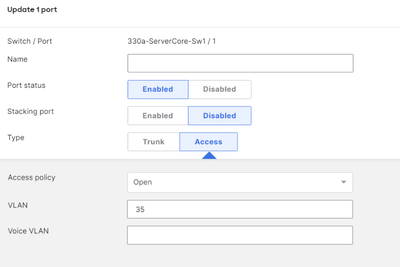

My AP's to the switch are set as trunk ports.  My port from switch to firewall is Access.  I did submit a ticket to my ISP to double check the firewall is correct.
ww
That sounds like the problem. A access port transport only 1 vlan(native).   If you want to use more vlans from the firewall you should have trunk ports transporting those vlans

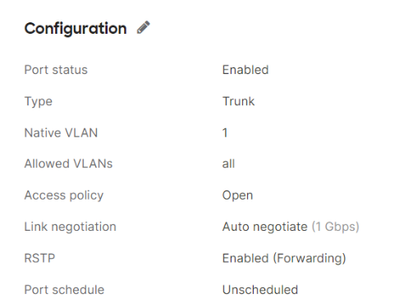

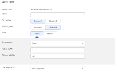

Almost had it.  I was able to get the correct IP address but I had no internet.  I got no internet on both my secure or guest ssid.  Could the trunk port for the AP cause issues?  They are not set for vlan 35
ww
That looks fine.  Maybe vlan 35 is also tagged and native should be 1 on the uplink?, but your previous config shows access port vlan 35, thats confusing.
What management IP/subnet does you AP have?
CMorinski
VLAN 1 is for my wired devices.  My AP's are pulling their IP from the wired DHCP pool.
