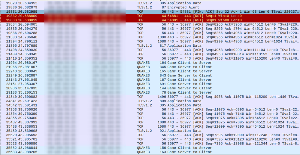

mer.pngHello,
I configured a guest ssid with external radius on Meraki.
I entered radius ip and take capture from radius side there is no authentication radius from Meraki.
Any ideas?
