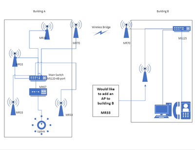

This may be a beginner question but I would like to understand the reason as to why it doesn't work. We have a bridge with two MR70's and on the remote side we have a MS125. We wanted to put a MR33 on the remote side for wireless. Why is a layer 3 switch required to have a AP connected to the switch if everything is on the same VLAN?

Its just one hop from building a to b. We already currently have a MS125 directly connected to the MR70 repeater in building b. My question is why can't I connect an additional AP to that switch. (even if everything lets say is on VLAN 1) why is a Layer 3 required? Is it due to having wired and wireless clients? I understand the repeaters only transfer untagged traffic but if there is only one VLAN why doesn't it work?

We would like to have a switch for network devices that require POE (VOIP) but not all clients are going to be hardwired (reason we want an WAP)

The OP isn't trying to do multi hop mesh. They're trying to use a wired AP on the switch connected to the repeater AP like this topology. By default this fails when the repeater sees another AP on its LAN side trying to get DHCP.
I've been running a quick test here in the lab and if I give the remote side wired AP a static IP everything seems fine. Gateway AP is up, repeater is up, switch is up, remote side wired AP is up, client is connected to the SSID broadcast from that remote side wired AP.
OP you may want to test that out and see how if it works for you. Obviously in this config the remote side switch, AP, and clients all end up on the single VLAN mapped to the mesh AP wired port (the SSID listed under the network-wide page section called "Clients wired directly to Meraki access points").
Also if for some reason the static IP stopped working it would revert to DHCP and possibly take the remote side switch offline/unreachable.

Thank you for your help. So although it it possible to make this work it’s more ideal to have a L3 switch to allow for multiple VLAN’s as only one VLAN is allowed over the bridge due to it being untagged traffic?
Ryan_Miles
Meraki Employee All-Star
That’s another scenario I can test tomorrow using multi VLAN mesh.
But yes to adhere to official documentation this topology would require a L3 switch on the remote side.
