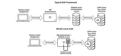

So reading this:
https://documentation.meraki.com/MR/Encryption_and_Authentication/Meraki_Local_Authentication_-_MR_8...
I thought, well, let's use OKTA as LDAP for local auth, and so far, after a lot of back and for i was getting communication between Meraki and LDAP
I can get communication on the testing side so clearly Meraki can communicate with OKTA as LDAP on port 389
Now on site, clearly the AP is not responding to the clients attempting to authenticate:
Client made an 802.1X authentication request to the RADIUS server, but it did not respond.auth_mode='wpa2-802.1x' vlan_id='7' radius_proto='ipv4' radius_ip='127.0.0.1' reason='radius_timeout' radio='1' vap='5' channel='40' rssi='45'
My intention was something like the next:
The AP will accept 802.1x connections, hand it off to 127.0.0.1 for RADIUS and that will then reach out to Okta
Or you feed it a private CA cert to trust, and it will verify the certificates clients hand it.(which i did, using OKTA Certs)
Is this technically possible or I'm just dreaming? Meraki support told me, maybe, then no BUT they sent me to ask OKTA.
I just want to understand why I would need a local Radius Server at all when in theory, the LDAP entity is our OKTA instance and I'm able to connect with Meraki.
