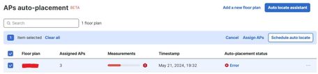

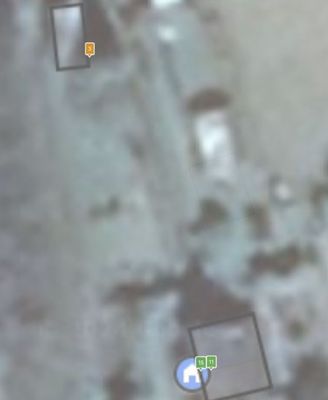

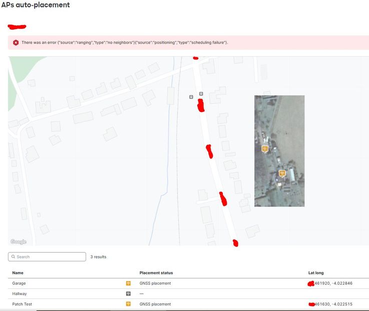

I tried it on my network with 1x CW9166 and 2x CW9163E and this was the result:
  1. You need a floorplan for it to even run, so I added one.
  2. It will momentarily disrupt wireless data access while measuring and took about 2-3 minutes in total
  3. It errored, see below
  4. The error seems to be that it only works for the CW9163Es as they have the GNSS receiver.  The CW9166 needs a USB plug in module for GNSS functionality
  5. But it works and all three were placed pretty much exactly where they really are!
