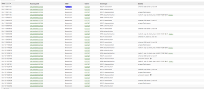

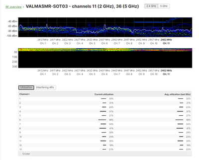

These new laptops with 802.11ax have WiFi disconnections in some of my clients' devices. I was able to fix discovered a way to prevent them more easily I update drivers up to date and force 5hgz. The identical pattern is now on fresh laptop. I was curious about your issues. Why did this occur?
Any idea ?
AP MR44
Up to date
Current version: MR 28.7.1

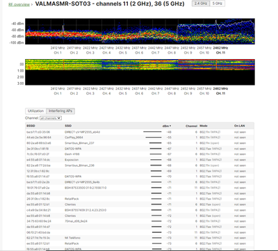

He is moving to throught these AP´s
An example AP

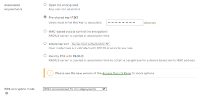

These information are not helpful. What type of authentication are you using?

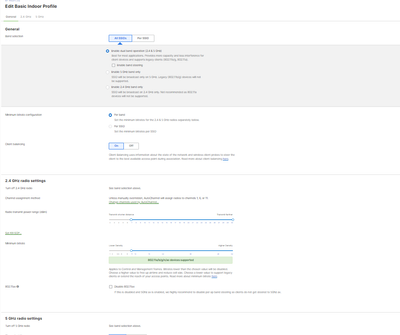

Can you share your SSID configuration and RF profile configuration?
athan1234
A model citizen
Sure
Thanks, It looks well, the 802.11r and 802.11w are enabled? How the Client IP assignment is configured?

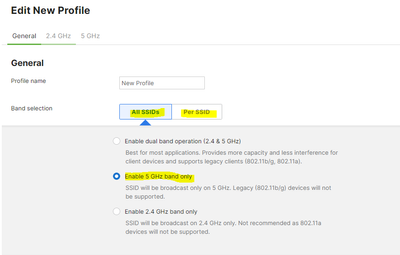

Also, can you configure an SSID for 5Ghz only?

Yes, I can, but not if there are more uses. 2,4Ghz

About WLAN, I suggest creating a new one (not changing the existing one) only in 5Ghz, to test this 802.11ax client.

Yes,I thought to do performing an RF test . is it possible to do a RF only for a user o users ? I belive it was possible only for SSID or AP
I didn't understand the question "is it possible to do a RF only for a user o users ? "

You reply me :
"About WLAN, I suggest creating a new one (not changing the existing one) only in 5Ghz, to test this 802.11ax client."
I assumed you were telling me to create new RF profiles, I can only do so using the SSID no for  client or user
You don't need to create a new profile, just change It to "Per SSID", and selec what band you want to use.

Therefore, those who lack 5Ghz in their laptops are unable to access this SSID. It would be a problem , many users don´t  have 5Ghz
@athan1234
I see, that's why I  suggest you to create a new SSD just to test clients that support 5Ghz, it looks like those clients are floating between bouth bands.
