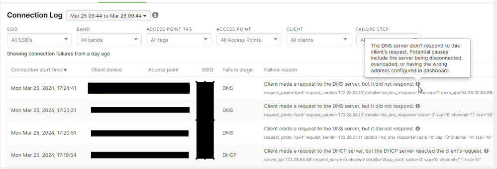

I have a set up a wireless network for one of our remote site where clients are meant to obtain an IP address from a DHCP server located at Head Office . However  I m unable  to connect to the SSID and getting the following error from the connection logs .
The Addressing and Traffic configuration is set to bridge mode  where wireless traffic has been tagged to Vlan 10 .
I can confirm the DHCP server is reachable as I can connect to different SSIDs that tunnels traffic to a concentrator .
Not sure where I m getting it wrong
Can  anyone please assist  ?

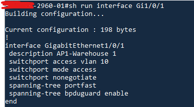

This s how the remote site is connected to Head Office . I can also  successfully ping the DHCP server from the switch . DHCP relay is also configured on the SVI  for Vlan 10.

Is the switch port native VLAN 10? If so, don't also tag the SSID for VLAN 10. Either don't tag the SSID or set the switch port to another VLAN if you want to tag at the SSID level.

Thanks All  for your helpful  feedback . Yes DHCP works fine  while connecting a device on the wired network . I believe the issues resides with the fact I have configured Vlan tagging on the SSID while the switchport interface is set as an access port . Since this s a flat network with only Vlan 10 and Vlan 1 as native , I would need to to remove tagging I suppose . Will test and see how that goes

I have  tested once again but getting the following while attempting to connect " Connected , No Internet " . The connection logs are displaying the below messages .
I can confirm we have connectivity to the DHCP server ( works with wired devices ) , we have also successfully tested  another SSID  where traffic is being tunneled to an MX-400 appliance . It does not seem to be happy with the  SSID that s being set up in  bridge mode ( this s the preferred connection method ) .

Here s the config
Switch
SSID
Any assistance would be appreciated

Its now sorted ,  it looked like some of the  " Firewall & traffic shaping " rules for the relevant site were preventing clients traffic to get to the DNS Server .
