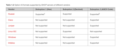

Have you not read the vendor's documentation?
cgw
Tried various options & the working solution was 01:08:0a:14:0b:07:0a:14:15:07 using suboption 1, pointing at controller IP addresses 10.20.11.7 & 10.20.21.7
