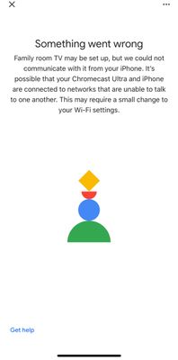

I tried the same Rick with Chromecast Ultra but no luck.
min getting the following message.
Any suggestions?
Make sure you are using bridge mode on the SSID.

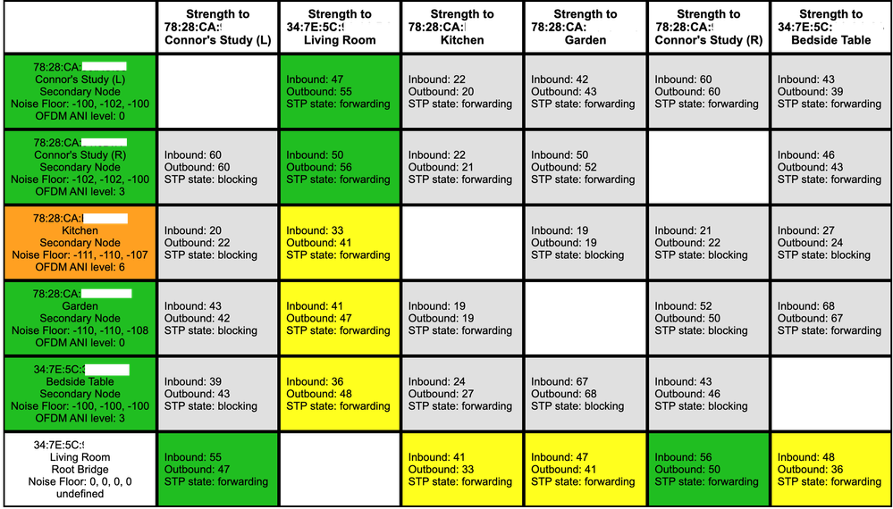

Fun fact if you're using SonosNet, you can browse to sonosipaddr:1400/support/review (replace with the actual IP address of one of your Sonos speakers, you can find this in Network-Wide > Clients) and view the STP and network matrix info, this helps pinpoint issues with STP and meshing issues for example.
As you can see in this diagram, all speakers mesh to the Living Room Beam, you can see the relative signal strength and STP states here too. Make sure you don't wire more than one Sonos if possible, else you'll likely get an loop, so long as your core switch has the highest STP priority you should be okay - you really don't want user traffic being sent over your SonosNet mesh.
As much as I wanted to have Sonos and other IoT/Media devices (like Chromecast) on their own VLAN, it just doesn't work most of the time and is more work than it's worth. Keep the end-client and Sonos on the same VLAN and you'll be fine

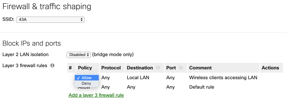

Just a quick update to state: remember to set Wireless > Firewall & Traffic Shaping Layer 3 "Wireless Clients accessing LAN" to Allow. By default, the first SSID of every Meraki network has this set to Deny, which will cause issues when setting up & operating your Sonos Equipment. It's such a tiny dropdown menu that is easily missed, but gosh it can cause some headaches!
When I was new to Team Meraki and got an MR42, I shamefully spent hours setting it up with no luck, this lil' dropdown saved my Play:1s from being tossed out the third story window.

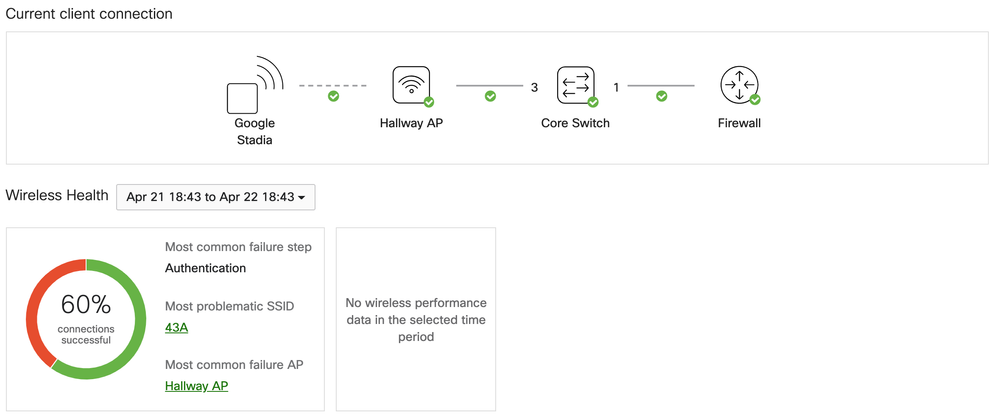

Hmm, I've never really had an issue with my Chromecast Ultra, so long as you've got it in Bridge mode with the firewall rule allowing Wireless > LAN traffic (Wireless > Firewall & Traffic Shaping) set to Allow, you should be fine.
Gotta admit, Google Stadia is flippin' awesome if you're on a decent broadband connection.
I had a brief outage last night with my Ultra however, just wouldn't connect and asked me to use the Google Home app to reconfigure it, I had to make it connect to the guest network, then back to my main SSID for it to finally come online, it was 11pm so I wasn't willing to take a monitor mode capture, but a quick Google suggests it's a bug on their end (perhaps). Other than that, it's been fine.
