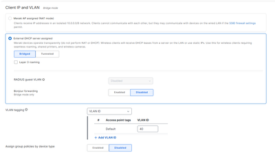

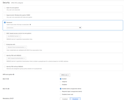

Yes,
Share configuration dashboard

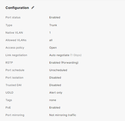

Port Switch
Are there any particular settings for wireless printers?
No, there are no particular settings for the printer.
And what about the port connected to the MX, how is it configured?

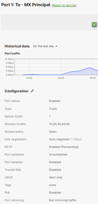

This is configuration port switch with conection MX
Configuration MX : all vlans
