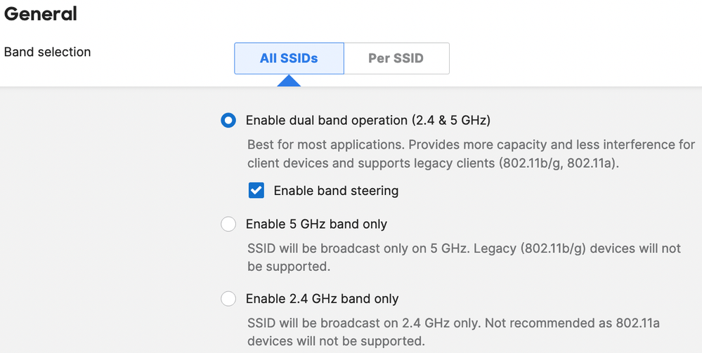

Hello RYMILES!
Thanks for getting back to me. I am new to this role and have just been able to view the Meraki AP Settings. Should I check "Band Steering" for all SSID in the General Section or uncheck all the band selections for 2.4Ghz and 5Ghz and leave the Band Steering option checked on the "Per SSID" tab?
Can you provide me with a little direction.
Thank.
~ Jerry
The band selection section will use whatever mode you have enabled. So, if you have selected the all SSIDs tab only the options below it matter. That said I'd use All SSIDs mode, dual band enabled, band steering enabled.
