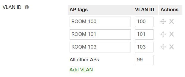

@jdsilva  Out of curiosity, have you had any luck on this front via the following?
I'm assuming their is going to be a limit on this feature no?

@NolanHerring You don't need to configure any of that if you return a VLAN via RADIUS. The AP receives the attribute, assigns the VLAN to the client, and Bob's your uncle.
https://documentation.meraki.com/MR/Client_Addressing_and_Bridging/Tagging_Client_VLANs_with_RADIUS_...
Or, you can return a GP name, and assign the VLAN through the GP:
https://documentation.meraki.com/MR/Group_Policies_and_Blacklisting/Using_RADIUS_Attributes_to_Apply...
