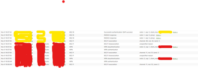

WiFi logs during my laptop tests in the location where public failed every time.
Red is public SSID yellow is internal SSID
