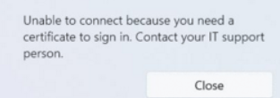

Might be being impatient as we just set this up but getting this error on the devices we have deployed to. Which cert do we upload back into the Meraki portal? The Issuing CA
Akeon
Check the cert you are pointing to in your intune wifi profile is actually deployed to the device/user
Open MMC
Add Certificates snap-in (local computer for machine certs, My User Account for user certs)
Go to personal certificates
Check the cert has been deployed.
Yes the issuing CA gets uploaded to meraki.
Daniel-GAC
Okay the SCEP cert does not seem to be deploying and we dont know why haha.
Intune just says "Error" which is really useful. How do we get it to deploy properly for user certificate store?
Thanks in advanced!

Out Cert's keep deploying here! Not sure what we are doing wrong. But we are going to start again and re try the setup with user auth rather then computer.
Akeon
Mine show up in root under computer (not user). When creating the trust profiles in intune, for:
Root CA
Issuing CA
Iden Trust
I am selecting Computer certificate store - Root
Then when adding the mmc snaping be sure to select the local computer store.

jrhop
Its towards the bottom of the WiFi configuration profile. You will need to put the server certificate name and the root certificate. This is to prevent a MitM situation, connecting to a rogue WiFi network.
CGRE
thanks, and that server is the Meraki AP, either network or org name (but I can see the org has a wildcard so doesnt work?)
so the server name entered is like this xxxxxxxxxxxxxxxxxxxxxx.radius.meraki.direct
trying to do a whole org *.radius.meraki.direct wont work because of the wildcard, if this is the case how are people configuring a whole org for this, does it mean a profile created for every single Meraki network?
jrhop
It is whatever server its connecting to, for us we are using NPS for RADIUS. But I did test the Meraki one, pretty sure it only worked when using the full one for the current network. I think not being able to use wildcards is an Intune limitation. You can have multiple entries in the Intune WiFi configuration, so you can list all the entries for all the different Meraki sites (not sure if there is a maximum you can specifiy). Just make sure you also upload the root CA and specify it in the profile as well, as shown in previous screenshot.
CGRE
Thanks, am using the Meraki inbuilt as wanting to avoid NPS as in my instance that needs a server spun up in Azure just to run NPS.
I noticed that you can add multiple entries, hopefully it doesnt have a low limit on those as with a larger org it could have a lot of entries, shame it doesnt like the wildcard as that would make it simpler but if its a by design limitation for security reasons it does make sense.
CGRE
Current settings from intune, have the server name matching the network name, still get the prompt on the client in order to connect?
CGRE
FYI we resolved this issue, what we were missing was the Identrust cert that Meraki uses being in the InTune wifi profile, once added the client machine issue "expected at this location" message no longer occurs, it auto connects with no issue.
jrhop
Is this with the wildcard or without it?
CGRE
No wildcard, from everything I've read InTune wont like the wildcard, so networks have to be added individually, you can add multiple names to one profile though, am sure there will be some kind of limit but cant find what that is.
