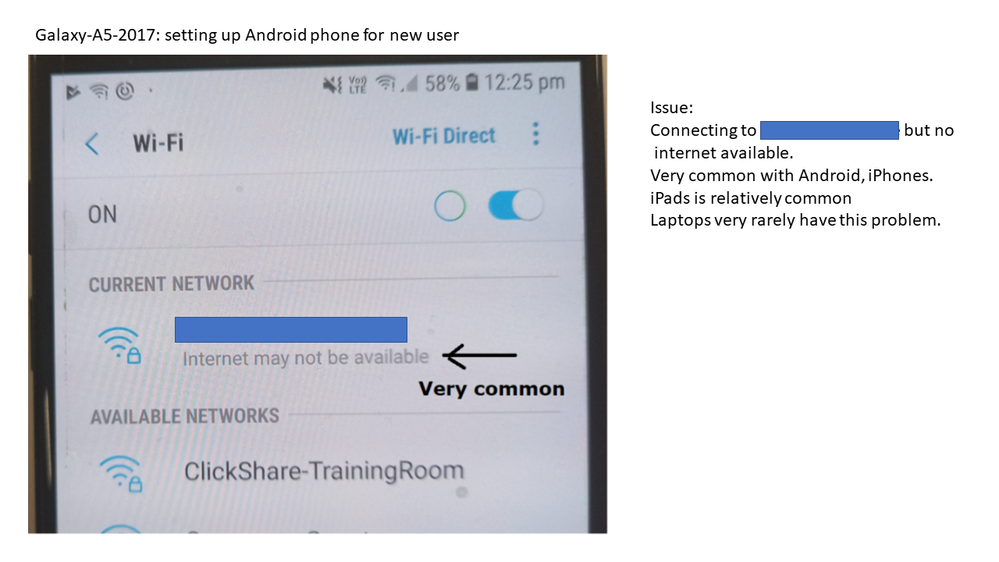

I have been in my work here now for 8 months. In that time there has being a consistent problem with Androids, iPhones, iPads, but strangely not laptops, not getting wireless access.
At times it seemed that none of these devices could access our wireless. My own Android had 7 months of no access.
As I began to wander the Meraki portal and check configurations I noticed that 1 WAP had its primary DNS set for our French parents DNS rather than the local Australia DNS. Once I changed that the ability to get onto the network improved dramatically. Even my Android could finally log on (not sure why 1 WAP configuration error could affect the whole network).
Now the problem is that the internet is unavailable so many times. More looking at the portal showed many association failures (we can get 2/3 association failures on a bad day).
As an example here is the result of my trying to put a new Android onto the wireless today (19/11).

I have not touched this thread since Nov. 2021. In the meantime w e had an outside 'expert' look at our Wi-Fi. that was a waste of time and money.
In the last 2 weeks our helpdesk is reporting multiple notices from Meraki about clients failing to connect to the network. Nearly all seem to be Android devices to me at least.
I have attached some screen shots from our portal with some information. Authentication is the step failing most often.
Is this something blinding obvious I am missing or is most information required?
