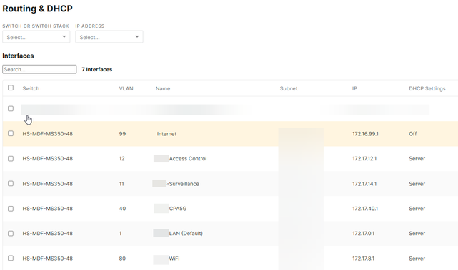

My DHCP is handled by the MS350. Under Switching - Configure - Routing & DHCP I have created multiple interfaces.
For example:
I want clients connecting to the "WiFi" to get IP addresses from the DHCP server set up on VLAN 80. Currently they are only getting IP addresses from VLAN 1.

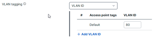

Under the SSID settings, I tag VLAN 80.

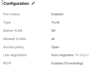

All of my switches are connected using SFPs. Those ports are configured with like this:
VLAN 99 is my management VLAN, all switches are configured this way. What do else do I need to configure before pulling the trigger on the SSID setting?

The ports that APs are connected to are Trunked with the native vlan of 99 as you've shown above? Your SSID settings appear correct, so I'd be verifying the APs are trunked on a native vlan other than 80 and that 80 is an allowed VLAN

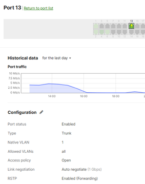

Those settings are for the SFP ports. My switch ports are set up as follows. This is a port with attached AP.
Mloraditch
This looks like it should work.  If you statically IP something on VLAN 80 and connect to the SSID in question does it work?  If not does it work (DHCP or static) if you put a wired device on access vlan 80? If you don't see something obvious (bad trunk) you can do this starting with your core switch and moving outwards to try to identify where the problem is.

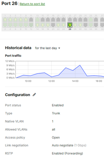

The switch port where the access point is located must be configured in trunk mode.
VLAN in the SSID as per the image you sent.
Digitaltek
Are you suggesting the following change:
Before                                                             After
Digitaltek
I made that changes I last posted. Currently all devices connecting to that AP are pulling from the proper DHCP server. I am going to test further and report back. Thanks to everyone for the input.
