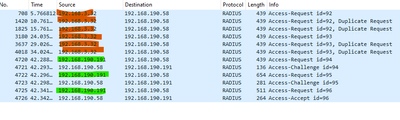

Hello everyone,
does anyone here know anything about the function of the AltMgt interfaces in the firmware >MR30.x ? The support knows that it does not work, supposedly they are working on a fix.....but for almost a year now.
The whole issue is slowly becoming a show stopper.

It is primarily about the RADIUS feature via the AltMgmt interface. Support has confirmed that there is a problem here and there is currently no fix.
The problem is that the requests to the RADIUS are sent via the "normal" and not the "alternative" interface.

After massive testing and tickets it seems this feature to be broken. Followed the advice to use DHCP at the AMI instead of static. Did factory resets but at the end, a wireshark of the attached switch port still shows the RADIUS packets to flow with the Mgmt-IP instead of the AMI-IP.
I'm really at the end of my tether, I can't update the customer's APs and am stuck in version 28.x. Great.

After more testing it seems the AP uses somtimes both interfaces.....red marked is the MGMT and green marked is the AMI interface. What the hell I'am doing wrong? 😞

Firmware version MR30.7 has been released with a fix for this issue.

Just tested 31.1.1 and it runs as if nothing had happened 😎.
30.7 I'am going to test out now.
MK2
Building a reputation
I can confirm that 30.7 also fixed the issue. 🚀🎉
