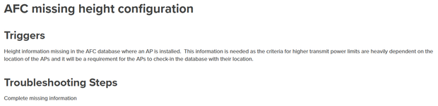

One of my CW9163Es has just started displaying the error:
  • AFC missing height configuration
The Meraki help just says this...
Has anyone else had this come up and know where to complete the missing AFC database information?
