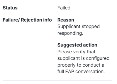

Thanks Chris, We already uploaded complied cert of root and intermediate CA and uploaded to the access manager.
It is giving below error.
