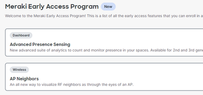

While it's not a perfect tool, the AP neighbour section, might provide evidence as to what is causing the high interference. It's an EA function, so you need to enable it:

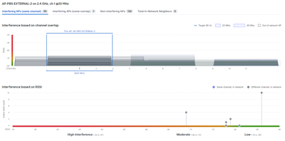

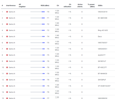

Once enabled, you can then drill down into each AP to look for overlapping/Interfering APs:
Alternatively the RF Spectrum section might provide some evidence, but neither of these tools will identify what would be causing any non-802.11 interference...you'll need some proper kit to determine and identify those issues.....
