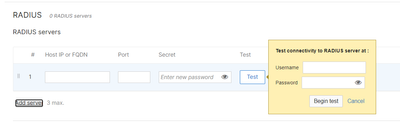

Dear All,
           One of our customer using merkai AP, and they have 15 AP in the network, and suddently today there are 3 AP show alerting, with warning below, and they have NPS radius to allow AP and user autenticated to the network, all the AP IP has added into the NPS list to permit for connecting, but only 3 of the AP get prompting below, any idea what goes wrong ? any help would be appreicated
Recent 802.1X failure
A recent RADIUS test encountered a connectivity issue. Please check your RADIUS server settings.

Have you tested the Radius Server communication on Meraki Dashboard? Have you checked the pre-shared key configured on your Radius server?

finally its an issue with the NPS radius policy setting, its resolved thanks
