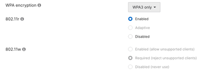

The Emoji SSID, is in WPA3 Transition, but doesn't show up when in 6 Ghz only. If I enable it on 5 GHz aswell is shows up.
Disabinling  5 GHz again, but changing it to WPA3 only, makes it show up on 6GHz only.

I am having this issue as well, when set to WPA 3 Transition mode and only 6 Ghz selected, SSID is not broadcasted when 5 Ghz selected SSID broadcasts and I can connect to only 5 Ghz (my laptop does support 6 Ghz)
If I set it to WPA3 only and 6 Ghz only I can see the SSID broadcasted and can connect on 6 Ghz

@AxL1971 I think that's intended, I've always seen that happen.  Otherwise the older clients would see the 6GHz and that's not part of the standard.
On another note WPA3 transition is terrible and to be avoided unless you hate yourself!

done more testing, with WPA 3 only and same SSID selected my laptop which supports 6 Ghz connects to 6 Ghz another laptop around 3 years old that does not support 6 Ghz connects to  5 Ghz
cmr
That's what you should see.  If you have another non 6e/7 Asp in the same network the WPA3 client should connect to the 5GHz on that AP and when roaming should step up to 6GHz.  I've got this reliably working with CW9163E/CW9166I APs.  Before you say the 9163 is a 6GHz AP, it isn't in the UK, or pretty much any of the world other than the US...
