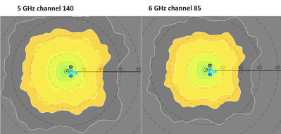

I'm in the ETSI area so I only have access to the UNII-5 band.  So it is important if you do predictive survey (yes Ekahau just does it) that you use the highest PSC channel.
As you can see from a simulation I made using an AP on the default 2.4 meter in height without any offset these are the differences on a CW9166.
I would assume the coverage is about 5 meters lower in circumference so that will add up in free space.
Real world losses through materials will probably not be as different as the 5 GHz but real live measurements will have to tell this.

Thankyou - An interesting discussion.  I use Ekahau for design, was really just after the likely reduction in coverage using 6 compared to 5 GHz.  Looking likely additional APs/structured cabling will be required to cover the same spaces.  Haven't had a chance to look at a site and survey/plan yet, but will be interested to see how it works out.
