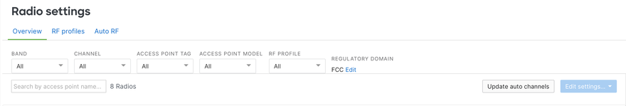

You can go to Wireless > Configure > Radio Settings and select the RF profile (tab) and select UPDATE AUTO CHANNELS to refresh the channels.  In my experience that has fixed close proximity AP overlap issues. 

Pressing the Update Auto Channels button on the radio settings page in the dashboard will force a one-time optimization of channels used by all APs within the dashboard network.
This will usually result in a minute or two of downtime as the APs adjust their channel.

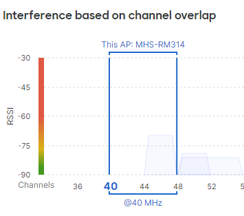

Take a look at this graph from AP neighbors.
It is choosing channel 40 for the channel.  40 isn't even considered one of the non overlapping 40MHZ channels.
I would really like it if I could have my all 40MHZ width APs choose only from the non overlapping.
EDIT:  Also, we still have a profile that uses 20MHZ channel widths as you can see from the diagram.  So couldn't this be a problem?  The 40 channel is looking at the 40 area for clear to send and then when data is transferring the 44 could be in use without it knowing since it is a 20MHZ channel and cause issues?

Jep that does look bad :s
It does not make sense an AP would choose 40+44 or 44+40 since that effectively causes problems for channel 36 and 48.  This would only make sense if channel 36 is disabled in the RF profile but this does look like bad behavior in the algorithm.
