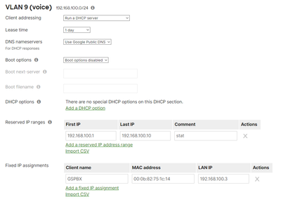

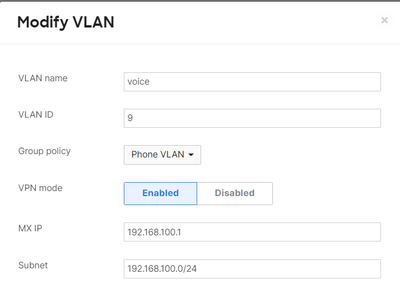

I am trying to get a set of devices to go to a specific VLAN. For some reason, even though I believe I am doing it correctly, it doesn't seem to "take affect" even after a reboot of the Meraki and the device I'm trying to assign a specific VLAN.
As you can see above, I have the policy set to "Phone VLAN", and the VLAN is also apart of the same group (below) On the right you will see the device is using "VLAN 10 - Default" not "VLAN 9 - voice", even though it should be through the group policy. The device in question is apart of the "Phone VLAN" group. Everything should be pointing towards overriding the VLAN its assigned to the group policy its on, but its not.

You don't need a group policy for this (in fact, they won't work for this).  Instead, configure the Meraki MS phone VLAN option.
https://documentation.meraki.com/MS/Port_and_VLAN_Configuration/Configuring_the_MS_Access_Switch_for...

Above is the only information on my Teleworker Gateway > Configure > DHCP page.
