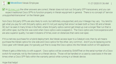

Well, I've never worked with unsupported transceivers, and as far as I can remember there is no specific configuration to support this. Probably if you open a case with Meraki they will recommend switching transceiver.

Given the fact no Meraki switches support SFP-GE-BX transceivers, I don't think you'll get too far with support.
Make sure the fiber pairs are the right way round (swap them if needed).
I would change to supported transceivers.  As others have said, there is no BIDI support.
