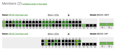

I have provisioned my stack consisting of 1 x MS225-48FP (SW1) and 1 x MS225-24P (SW2). These switches have been online and working as expected for a number of days.
The stack is cabled as per the stack creation guide.
Switch 1 - Port 1 to Switch 2 - Port 2
Switch 2 - Port 2 to Switch 1 - Port 1
Both switches are running the same firmware - MS 12.28.1
Both members are in the stack and showing online. Both can be pinged on their management addresses obtained via DHCP.
I seem to be experiencing the following error "This switch does not have a stack configuration."
I have started by removing the stack configuration, cables then rebuilding the stack using the official stack creation guide to no avail.
Any advice would be greatly appreciated.
