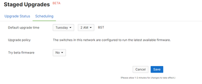

I need to upgrade 2 x MS350 and 2 x MS225 switches
Plan to upgrade the MS350 first then the MS225
Reading this I can do a staged upgrade of switches
https://documentation.meraki.com/MS/Other_Topics/Staged_Firmware_Upgrades_for_Meraki_MS_Switches
However I do not get the option to create a custom policy as stated above
  1. Under  Upgrade policy, select Specify custom schedule.
All I see is this

Have you scheduled the upgrade yet? Once you schedule the upgrade for the network, go to the network -> switch -> staged upgrades section and you should see the option to schedule the upgrades.
