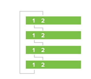

  4. With all switches powered off and links disconnected, connect the switches together via stacking cables in a ring topology (as shown in the following image). To create a full ring, start by connecting switch 1/stack port 1 to switch 2/stack port 2, then switch 2/stack port 1 to switch 3/stack port 2 and so forth, with the bottom switch connecting to the top switch to complete the ring.

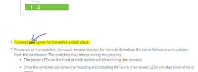

  1. Connect one uplink for the entire switch stack.

i dont get this part "one uplink for the stack"
what if that switch FAILS that has the uplink - shouldnt there be 1 extra uplink ? as per my diagram?

The single uplink would just be for building the stack in the first place.   You'd then create the aggregate link configuration (at both ends), for the addition of your second link.   you don't need an uplink for each individual switch.
https://documentation.meraki.com/MS/Port_and_VLAN_Configuration/Switch_Ports#Link_Aggregation
