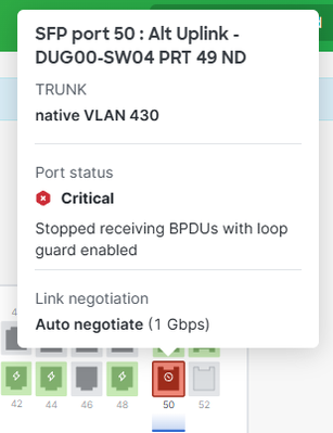

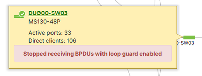

Hi All,
I hope we are well.
I’ve recently inherited a Cisco Meraki network following an acquisition and have noticed some alerts.
Edit - Added Network Topology/Switch overview (below)
Toplogy
Switch Overview

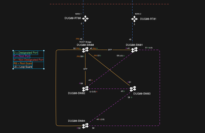

The network Consists of:
2 x MX105 in HA config.
5 x MS130-48P
4 x CW9166I
I've documented the network as best as possible..
(minus the access points) will re-review tomorrow and update asap.
Version 1
Version 2 - Since Reviewing Meraki Live Topology
- Root Ports mislabelled / corrected

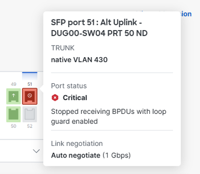

DUG00-SW01 Port 51
DUG00-SW03 Port 50
The affected ports seem to be alternate uplink ports, so the network is still operational. I’d just like to understand the issue and get the network’s RAG status back to healthy.
Any thoughts on the best place to start troubleshooting?
Thanks in advance - let me know if you need more information!

Not sure why 3 downlinks are needed….seems a bit overkill or over engineered.
Too many redundant paths likely intended for a failover situation but the errors seem to be the redundant paths (3 downlinks).
If it were my network to remedy, each switch would have only two downlinks with all root traffic from SW00.
SW01 and SW02 would be one alt path (loop guard)
SW03 and SW04 would be one alt path (loop guard)
I would remove the link between SW02 and SW03.
I would remove the link between SW01 and SW04.
Thanks for sharing the topology to better understand.
That would be my suggestion/recommendation.

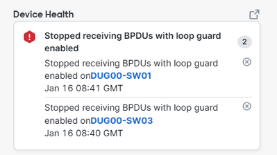

I realize you mentioned inheriting this network but the device health notice indicates SW01 and SW03 error notices yet the lower images you share indicate SW04 and the port descriptions don’t seem to jive.  Seems like something doesn't quite add up.

Can you share a screen capture of the topology from the meraki dashboard to see what that shows....I'm curious to see if that might reveal more insight.  Not meant as critical at / toward you....just tried to understand the above and I looked at it like 10 times.
IvanJukic
Hi @Sweemz ,
Not sure I follow the Topology Diagram either. Port 52 is directly connected to the Root switch. So that would be the Root port. Port 49 & 50 would be alternate ports.
I agree with @RWelch. The Topology map in the Dashbaord is 'live". So if the Tree changes so will the map. I use it daily. Best tool to use for these kind of queries.
https://documentation.meraki.com/MS/Monitoring_and_Reporting/Network_Topology
If you can share a screenshot, that'll be helpful.

Given the devices have already been purchased you could increase efficiency and redundancy. My preference would be to clean up the design, rather than chasing errors and warnings.
Judging by that Topology Screenshot. It Seems like, RSTP Priority is set to the default of 32768, and SW00 happens to be the Root Bridge. However, without actually looking into the Network, I can't verify.
Also, it looks like SW01 could be a Backup Root or potentially used as one. If so you could have;
A) SW00 & SW01 connected together as a Core/Distribution. With uplinks to the MX-HA Pair.
B) SW00 as Root Priority 0
C) SW01 backup Priority 4096
D) SW02,3,4 leave Priority as is. Then only have 2 uplinks, 1 each to SW00 & SW01.
E) All other Devices connected to only SW02,3,4

Not sure why I didn't include these originally 😅 .. Thank you for looking into this btw

Update - 27/01/25
2 x Links have been removed
  • Link between SW02 and SW03
  • Link between SW01 and SW04.
Updated Topology
Observation
Alert on DUG00-SW01 has disappered
Alert on DUG00-SW04 persists
Going to attempt port cycles on DUG00-SW03, Port 50 & DUG00-SW04, Port 49 to see if it gives it a kick. If the Alert persists I will also try a reboot of switches this evening to see if this clears out the alert.
IF all goes well I will then schedule in a FW update later this week.

Update as of 19:30 | 04/02/25 -
I'm happy to report that he remaining 'stp_loopguard_active' alert that was displaying for SW03 is now resolved 🙂
Looks like the Frimware Upgrade to MS 17.1.4 gave the switches a kick/reset.
