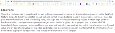

Big extra thanks to @cmr and @PhilipDAth for the clues I needed. Hooking the MacBook up directly to the Meraki MS250 did result in getting an IP address almost instantly, no interim self-assigned address. I should have read Philip's response a little more closely as I went off in my own direction researching the SG220s which led me to the Port Fast setting you referenced, although in the SG220 this is referred to as Edge Port, at least in the GUI
I changed the port setting to Edge Port for a couple of the ports, connected the MacBook and Boom! 4 seconds to an IP address, even with these clunky USB to Ethernet adapters
