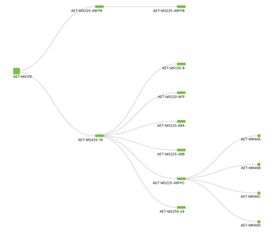

Currently all SPF+ or SPF modules connect OM3 fiber between MX and MS or MS-to-MS devices.
Are there any pros/cons if upgrading all OM3 to OM4 fiber (LAN wise or WAN wise)?
Dual WAN uplinks are CAT8 wiring to the business grade fiber boxes.
