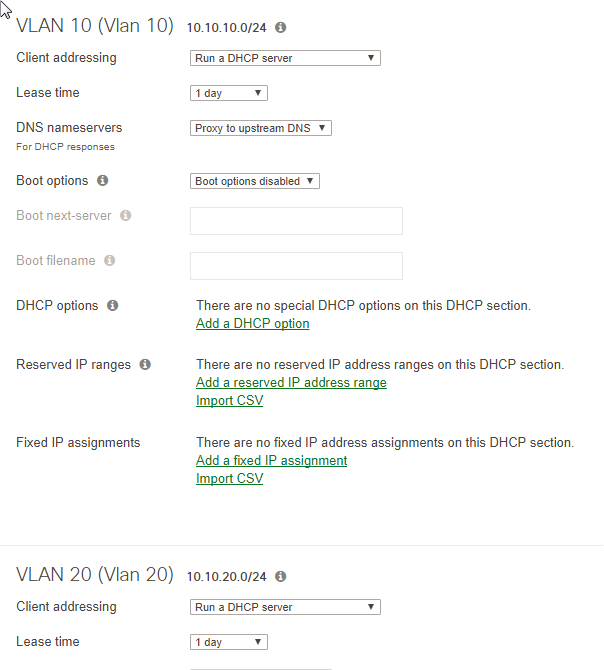

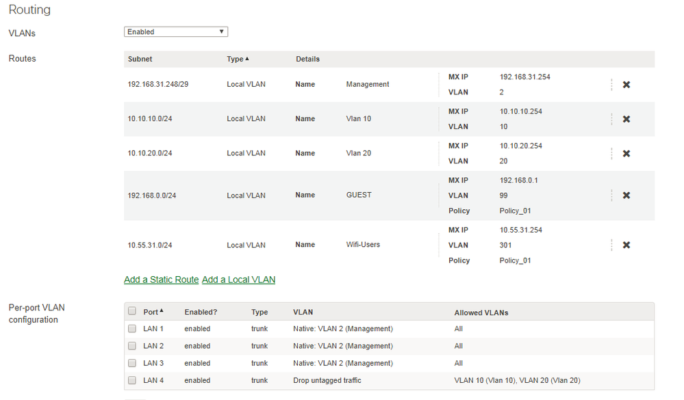

For your information, I configured today a MX LAN4 ports with tagged VLAN 10 & 20, all untagged traffic dropped.VLAN & LAN4 interface Config on MXVLAN & LAN4 interface Config on MX
DHCP config on MXDHCP config on MX

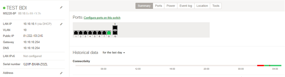

Finally MS got it's IP in tagged VLAN 10Finally MS got it's IP in tagged VLAN 10

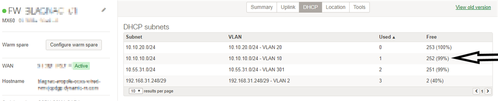

DHCP scope status on MXDHCP scope status on MX
 Finally, the MS got an IP because the device is really crafty 😉 This is nice and almost rare behavior in the industry. It's gonna be decisive factor for some of our customers !!!
